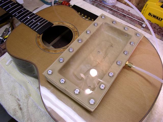

PostPosted: Mon Feb 27, 2006 12:04 pm
Posts: 409
Lance,
Do you have the LMI vacuum rig? I really wonder how hard it would be to make one? LMI's uses a 2 piece aluminum frame with a membrane sandwiched between, fitting for the vacuum hose, and a foam rubber type gasket on the bottom. Seems to me it could be make up from Lexan instead of aluminum, and LMI sells the membrane by the foot. If you have a chance, could you post some closeup pics of your bridge vacuum? LMI's pics don't show much detail. LMI's rig sells for $88, which isn't too bad, but the vacuum compresser is about $400 which is the killer. Someone on another thread posted about using a vacuum compressor from a frig or air conditioner that can be had for free or cheap used. Oh well, I'm off on another project.

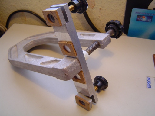

Russell, I had this worry as well, but it turned out to be unfounded. Get the bridge nice and hot, the food warmer tray sounds a good idea, I must test the temp of that, have your registration pins in holes 2&5 as your using the clamp through 1&6 and the bridge should stay where you put it while getting the clamp tight. As always, practice on a spare piece of wood on a bit of ply, and have everything to hand.

The bit I struggle most with in terms of a "quick fit" is the bridge plate caul, getting it in the right position between the clamp and bridgeplate. How do you guys (and gals) deal with this aspect? Do yo have the cauls attached to the clamp bottom with double sided tape etc?
PostPosted: Mon Feb 27, 2006 9:08 pm
Dave I use the Ibex clamp for my bridges together with one of Stew Macs bridge clamps (ironic eh!). I have drilled and tapped the Ibex clamps lower face so that I can screw the appropriate caul to it I them just have to rotate the caul into position when passed through the sound hole so that it's at right angles to the clamp. I tried it with tape but couldnt get it easily through the sound hole. Tighten the clamp and them tighten the two outer fasteners of the SM bridge clamp to clamp the bridge wings. Only one clamp to feed through the sound hole.
Sorry no caul attached, old picture pre modification, I hope I've explained it OK.
Colin S38776.2159606482

Colin,
Much gracias!!
I use the Stew Mac bridge clamp and the Ibex clamp so that would be perfect. I'll "tap up" the Ibex. What do you use for the caul? Up to now I've used birch ply, but have been thinking of making one from chopping board plastic.
By the way I've always found Stew Mac to be very good to deal with so I hope they "do the decent" with you on the circle cutter. I think under the circumstances you described I'd be a little "grumpy" too!!
PostPosted: Mon Feb 27, 2006 10:26 pm
Dave I've used birch ply as well, but your idea of chopping board plastic is good, may give that a go on the next one. I'm starting my first clasical so I need a new caul. Don't forget you'll have to drill from the outside of the clamp to get access. I've also covered the inside egde of the Ibex with self adhesive foam to protect the sound hole edge, from my butter-fingers!

[QUOTE=crowduck] Lance,
CrowDuck[/QUOTE]
I actualy use a home made jig, Don Williams made it for me and it works great!

Posts: 409
Lance,
Thanks for the pic! That confirms my thinking, it doesn't look that hard to make. Now, yet another project to deal with, but this stuff is great fun.
